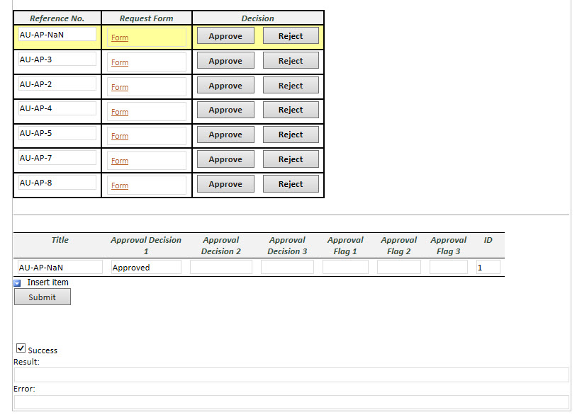

     There is no error prompted on the browser. As I see it, when I click the button, the changes is not save back to the list. I will try setting the postback on the button and let you know. Thank you.
  • 04-03-2014 05:15 PM In reply to
    Re: Qrules injected form working in preview but not on the browser
     Hi Hilary,
    I had try to set the postback setting of the button to always and still does not submit to list when in browser. Please see screenshot when I add the Error node. Also, is there a difference when a form is injected when selecting Sandbox or Admin Deploy? The form that is injected using Sandbox works in preview and not on browser.

     The ID is automatically set when the item in the above repeating table had changed. When the Approve or reject button is clicked, it will enter the change in the repeating section below and once submitted, the value of the Approval Decision is not saved back to the list.
