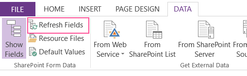

    Re: Infopath unable to publish workflow on Sharepoint DB upgraded from 2010 to 2013
    There is a way under the data tab in the ribbon to refresh the fields.

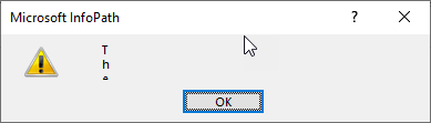

    when i use that... i get one of the error boxes.. .but the text is unreadable as i mess... i've also tried to preview the form. and it says it can't lookup a user (it's checking the user profile service after the form opens for info on logged in user). So i'm also trying to remember what can muck that up.... seems i ran into this before while testing a 2010-2013 upgrade (or doing so on our test server)
  • 09-03-2020 10:34 AM In reply to
    So for the unreadable error box - those are a pain. There was Windows update along the way that fixed that. But you can find the info in the Event Viewer on your machine - on my machine, they are under Applications and Services logs > Microsoft Office Alerts. I'd probably disable the user profile rule and see if that helps for previewing.... but my guess there would be that in preview it is using your AD account and the expected account info is your claims auth account.
