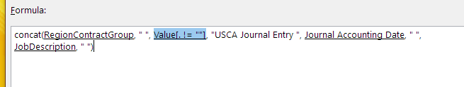

    I have a data connection for an email submit. Below is the formula I have in the subject line. The Field that says "Value" is a list filed that is populated on the form by choosing a check box and the "Journal Accounting Date" is a calculated field. These should up correctly in my SharePoint List, but nothing shows up for these 2 fields in the subject line of the email that is generated, all other fields display correctly.
    concat(RegionContractGroup, " ", Value, "EMEA Journal Entry ", Journal Accounting Date, " ", JobDescription)

    Looks like the Value is from a multi-select. You might try adding a filter to that - see the attached screenshot - so that instead of getting the first value, which is what your formula currently does, you get the first non-blank value. I also see the formula refers to the Journal Accounting Date, not the Journal Date. You might want to temporarily put the Journal Accounting Date field on the form so you can see the value. Since it is calculated, and this is a list form, I think there is a chance the calculation isn't occurring until the data is in the list...

    Re: field not populating in email submit
     ok the filter worked, except that I just grabs the 1st choice if there are two or more they do not show. is that an easy fix?
