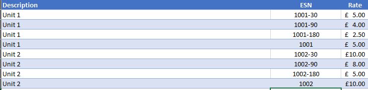

    Yes, the description drop down does, this is the only way I could figure how to make the list work at the time.
    So on the SharePoint list the description is repeated 4x, each with a different ESN code and a price. An example is shown below.
    I am assuming that this is the problem? Is there a way to work this better?

    First I'd verify this is the problem - but it is one I've seen before. Do you see the same issue when you preview the form? If so - deselect that option and preview the form and see if this fixes it. Worst case, you can create a single list for the distinct descriptions and make that a lookup on your other list....

    That's the ticket, I will have a play around making a new list with just the descriptions required and then re-format the ESN drop down if required, as the descriptions will match I have a feeling this will not be required as they will equal each other. Fingers crossed.
