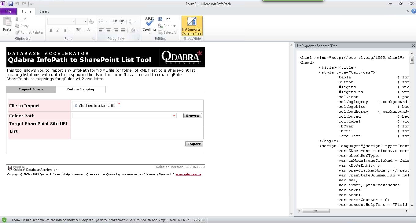

    I have a government laptop that is locked down tight.  I am having issues with Qrules Infopath Sharepoint to List Tool Form.  When I open the form, the schema at the right only shows HTML code.  I attached a screen shot.  I have reinstalled Qrules and verified the form is set for full trust.  Any help would be great!!!

    Additionally to tyty4u2's post above, we are working on this together and although we are using a DoD machine do have the ability to log in as the system administrator (for the machine) if we would need to allow features etc.  We've used Qrules on other DoD agency networks, however this is the first time with this agency.  Could it be security / policy blocking us from creating the mapping?

    Hi guys,
    Yes, it's a security issue with the form. The tool needs to be installed as "admin". Otherwise, it won't be truly full trust.
    Keep in mind that the task pane is just there to help you figure out the names of the lists, columns and XML, but you can do this manually if you are having security issues.
    If you've purchased the product, you can get up to an hour of hands on support by emailing support [at] qdabra [dot] com.
    Please contact us and we'll help you through it.
