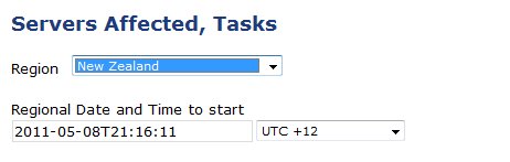

    Hi guys, I have a rather complicated web based change control form, that allows you to pick a region, and the form will automatically put that regions current timezone in.
    change control form

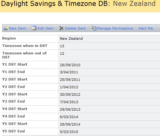

    In the above image, there is a dropdown box (populated by a list in sharepoint) that allows you to pick a region, when the region changes, it looks at another list (below) that stores the daylight savings dates for the next 5 years
     example of daylight savings times

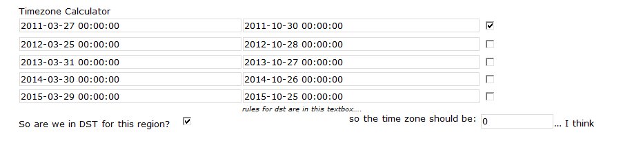

    Then, I populate some hidden textboxes with these dates, and workout if today falls between them, if so it checks the checkbox next to it (in this example, I am using UK as the region, so you can see that we are in DST
    timezone worker

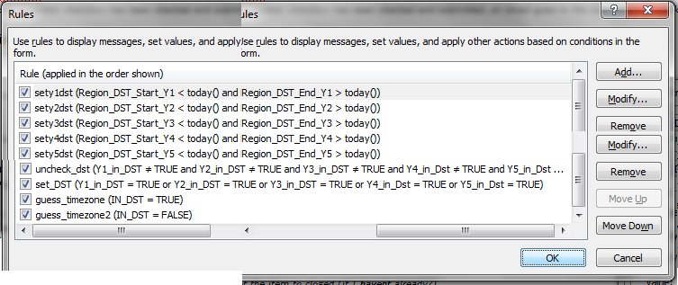

    the  rules work like so:
     rules
     First five rules will set the checkbox if today is between the two dates
    the 6th and 7th rules 'sum' the checkboxes, IE, if any of the checkboxes are checked, then a 'total' checkbox called 'IN_DST' is checked, if none are checked its not checked
    8 and 9 will do a lookup on the list again, if in DST is true then set the timezone to whatever the list says the timezone should be if in DST, OR if IN_DST is false, then do the opposite.
    This is the Logic Inspector of the above explanation:
