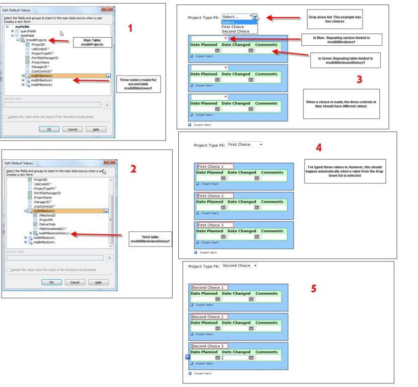

     As you know, if you have a repeating table/section, you can go to Tools-Default Values and add more nodes to the data source. If two nodes are added it will mean when the form is previewed there will automatically be two repeating tables on display.
    Lets say I want to automatically populate a particular field (called fld_ID) within each repeating table , I can go into Default Values and select fld_ID and add a value to it and repeat this on the next node with a different value.  If I add 1 to the first nodes-fld_ID and 2 to the second nodes-fld_ID, then preview the form, I'll see the two repeating tables. The first table's fld_ID will have 1 and the second will have 2 populated.
    What I'm trying to do is dynamically add the default values when a value from a drop down list is selected.  Depending on the value on the drop down list, different values in the nodes fields will change.  I've tried to do this by entering values using such techneques as the filter from within the Defualt Values and adding a formula to each node. However, doing this on Node 1 -fld_ID changes all fld_IDs in all nodes.
     Is there a way to do this so that the drop down box will populate different values to the fields on each repeating table depending on the value in the drop down?

    I've attached some screenshots to elaborate what I mean.  The drop down list adds values to the Main parent table (msdbProjects) and depending on that value, I'd like the node fields populated appropriately.  As you can see from screenshots 3 - 4, if the drop down list value is [Choice One] then there are specific values that enter the three tables Field_IDs (these ID's being the same field but a three rows are created in the database).
    If I go to [Default Values] and put the formula you suggested in one of the nodes field_Id's, then the formula is carried to all of the nodes and this would mean that each of the repeating section controls (Field_ID)  would have the same value.
    I hope this help explain and thanks for your patience on this:)

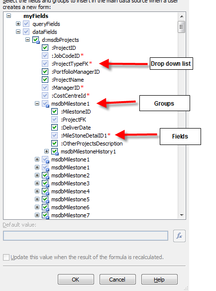

    I've spent a bit of time with it and am having difficulty with the syntax because I'm using fields from a database.  I've tried this
    substring(concat("1", count(/preceding-sibling::msdbMilestone1/@MilestoneDetaiID1) + 1), 1, (../../@ProjectTypeFK = 1) * string-length(concat("1", count(/preceding-sibling::msdbMilestone1/@MilestoneDetaiID1) + 1)))
     I've taken some of the elements and played about with it but no joy!  I've asked for quite a lot from you. Perhaps you can help me just a little more.
    I've attached a screen shot of the default values that I'd be using, maybe you could help me with the syntax?

    I've managed to get rid of the error with the code below but the controls all give me '11' when I select 1 drom the drop-down (I've only tested the code with the first part of the code below).  rather than the first field giving me 1 and the second field giving me 2 etc.  I've tried numerous attempts but all the fields in each section end up being populated with 11.
    Hope that helps you help me :)
