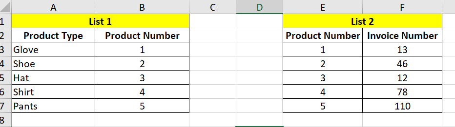

    Hello Hilary, I am sorry I couldn't explain very well. I attached my example lists. every product have their number. And When i create a new invoice it will be automatically get the last invoice number that belongs product number. For example if i create a new invoice form for "pants" I choice "product number" 5 than press "get invoice number" button, It will look the last invoice number for "pants" and its 110 now, form automatically create 111. If i save the invoice form the form automatically save invoice number for line 5 in "List 2" to 111. If i create new invoice for "Hat" it will check the "List 2" than automatically get "13" for new invoice number. If i save than "list 2 will update" I hope i can explain my idea. PS: I am sorry for grammar mistakes.
