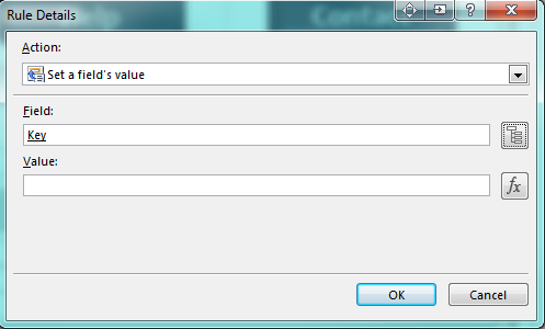

    I need to delete the contents of a field when particular selections are made.  I was attempting to create a rule which lists the conditions then have the action be to set a field's value.  I want the field to be blank and I can't see how to do this.
  • 06-14-2013 09:38 AM In reply to
    Re: How can I apply a rule to clear a field's value?
     For the rule, set the field's value and just don't fill anything in for the third box.

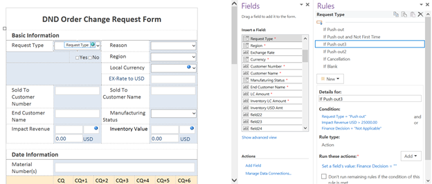

  • 02-15-2022 06:14 AM In reply to
    Hi Hilary, I am also setting a rule to clear a drop down list's value or make i's value as blank. Here is what I want to realize: When the Request Type is "Push out" and the Impact Revenue USD is 25,000, the Finance Decision value becomes blank (because I want the approver to modify it later). I have set up the rules as attached picture and attached infopath file. However, the rule "If Push out3" did not work. For example, keeping Request Type as "Push out", when I changed the Impact Revenue USD value from 0.00 to 26,000, the Finance Decision value did not becomes blank, it is still "Not Applicable". Do you know what is wrong with my rules? Thank you!
  • 02-15-2022 06:16 AM In reply to
    Attached is a picture showing the If Push out3 rule. It's in the "Edit Item-1" view.
