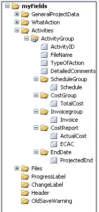

     May I also see a screenshot of the schema in your production form for my:myFields/my:Activities/my:ActivityGroup?
  • 05-31-2013 10:56 AM In reply to
    Here is the schema.
  • 05-31-2013 11:54 AM In reply to
    Re: Publishing qRules Injected Forms
     The mapping has ActivtyID for the ID - it is misspelled - missing an "i" between "v" and "t" - I didn't see it till I ran the code in debug and even then had to walk through it twice to catch that missing "i". Update your mapping file and try your production form again.
