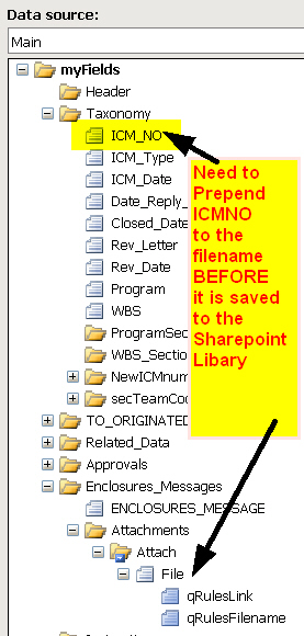

    I have created the required elements to use the qRules Command to save an attachment to a SharePoint library,
    It works OK but I really would prefer to concatenate a field name (ICMNO - see screenshot) to the file name before it is saved to the SharePoint library. I need to maintain the original file name as well, so I don't' want to simply replace the file name with the ICMNO. Just need to stick the ICMNO in front of it.
    I actually was able to replace the file name with the ICMNO + a date/time stamp, BUT that doesn't work because the second and subsequent attachments end up with same name and obviously, I end up with ONE file.  So sticking the ICMNO field on the front end of the original file name is really the best solution.
    I just can't get there.
    Any clues ?
    thanks!
    SaveToSharePoint /url=https://zzzz.web.qqq.com/eot/icm/xxxxx/ICMDOCS /xpath= /my:myFields/my:Enclosures_Messages/my:Attachments/my:Attach/my:File

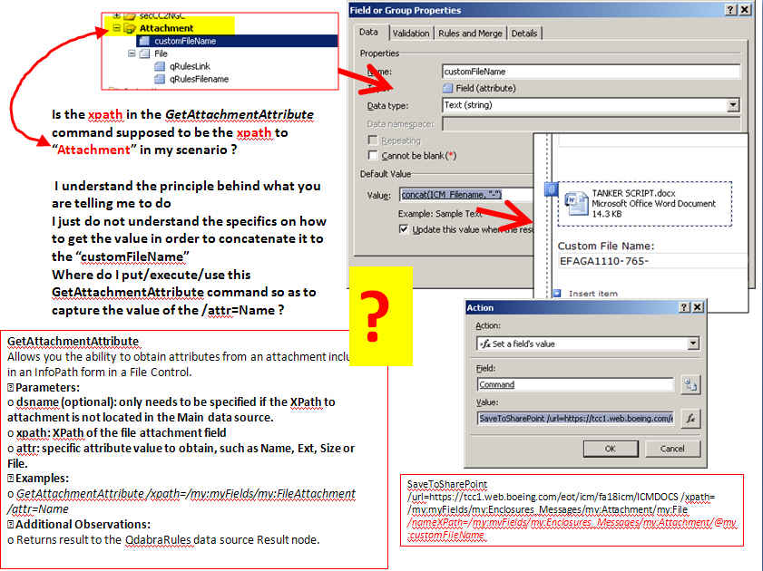

  • 09-16-2012 04:23 PM In reply to
    Re: Need To Prepend data to filename BEFORE it is saved to SharePoint library
    Normal 0 false false false EN-US X-NONE X-NONE /* Style Definitions */ table.MsoNormalTable {mso-style-name:"Table Normal"; mso-tstyle-rowband-size:0; mso-tstyle-colband-size:0; mso-style-noshow:yes; mso-style-priority:99; mso-style-qformat:yes; mso-style-parent:""; mso-padding-alt:0in 5.4pt 0in 5.4pt; mso-para-margin:0in; mso-para-margin-bottom:.0001pt; mso-pagination:widow-orphan; font-size:11.0pt; font-family:"Calibri","sans-serif"; mso-ascii-font-family:Calibri; mso-ascii-theme-font:minor-latin; mso-fareast-font-family:"Times New Roman"; mso-fareast-theme-font:minor-fareast; mso-hansi-font-family:Calibri; mso-hansi-theme-font:minor-latin; mso-bidi-font-family:"Times New Roman"; mso-bidi-theme-font:minor-bidi;}
     Thanks Hilary. I have to apologize because this environment is a bit new for me and I am not picking up on all the things you would think I should comprehend. I am pretty close but I just cannot understand the details of  HOW to use the GetAttachmentsAttribute to grab the file name so I can concatenate it to the new attribute I created for Attachment. i tried referring to the Qdabra qRules documentation but it doesn't help.see screen capture and embedded question, please.

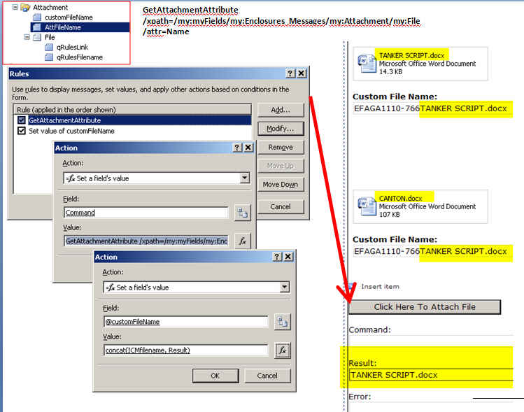

  • 09-16-2012 07:23 PM In reply to
     CLOSE BUT NO CIGAR.
    So I tried to follow your instructions the best I could.
    As you can see in the illustration, I created an attribute for "Attachment" called customFileName. I then put a button on the form that I clicked each time I added a file attachment.
    Rule 1 on the button runs the GetAttachmentAttribute and grabs the Name. According to the qRules documentation,  the results get returned to the "Result" node, so
    Rule 2 set the value of the customFileName to concat(ICMfilename,Result).
    For the first file I attached... PERFECT - just what I wanted.
    BUT, the Result node did not change when I added a second attachment and clicked the button again. Therefore the second customFileName ends up the same as the first.
    So what am I doing wrong ?? I feel like I'm so close I can taste it.
    Quite frankly though, I really don't think the users are going to want or are going to remember to click a button each time they add a file.
    I just did this to see if I could get close. The end game needs to somehow get wrapped up in the SUBMIT button that takes care of the whole Magilla.
    thanks
    DMN

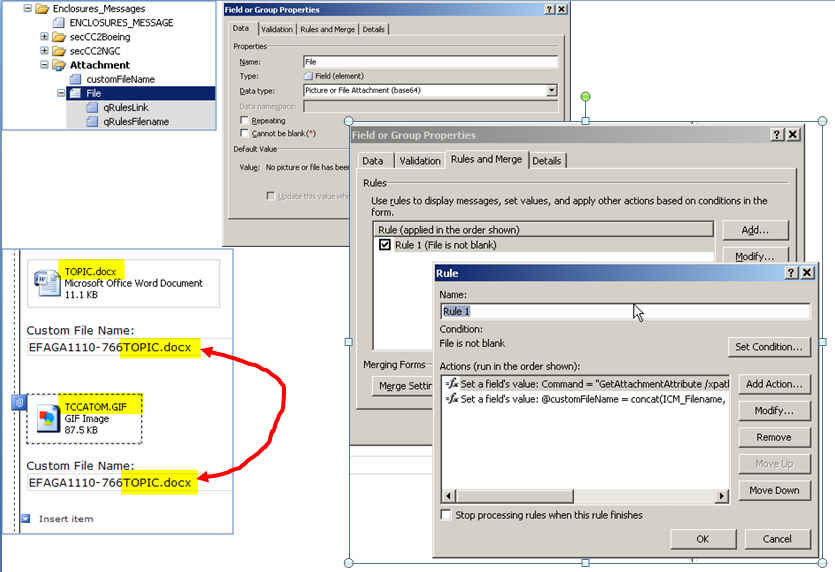

  • 09-16-2012 08:21 PM In reply to
     THIS DID NOT WORK EITHER...
    So I thought I would put some rules on "File" and try that, thinking it would eliminate the need to click a button.
    Basically I just applied the same command but stuck it on the "File" field with the condition "File" is not blank.
    Didn't matter. Ended up with same results. The qRules Result node did not change so neither did the custom file name.
    Is there some sort of refresh or reset for the Result node ??
    I just know that you are going to come back with some really simple thing that would have saved me hours of trial and error... but what the heck... I'm learning a lot in the process.
    DMN
