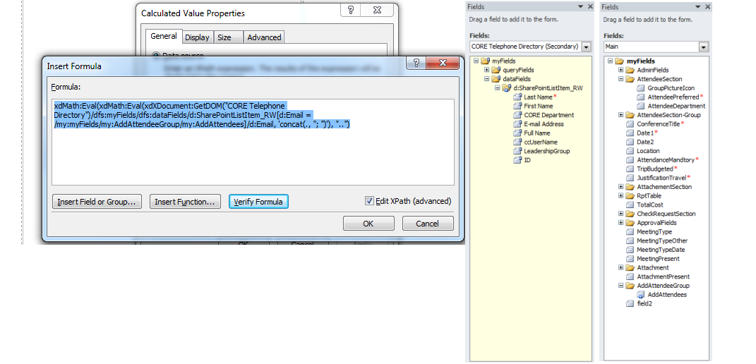

     I'm trying to get this example to work in my form but am having issues.  I have a MSLB with a secondary data source connection and want to show the selected display names in another field.  This is the xpath I've come up with so far:
    xdMath:Eval(xdMath:Eval(xdXDocument:GetDOM("CORE Telephone Directory")/dfs:myFields/dfs:dataFields/d:SharePointListItem_RW[d:Email = /my:myFields/my:AddAttendeeGroup/my:AddAttendees]/d:Email, 'concat(., "; ")'), "..")
     InfoPath shows no errors when verifying the formula, but when I test it out in preview the field remains blank
     Can anyone assist me with this?

    Thanks Larry for your response.   I was finally able to figure out what the xpath should look like with a secondary data connection.
     xdMath:Eval(xdMath:Eval(xdXDocument:GetDOM("CORE Telephone Directory")/dfs:myFields/dfs:dataFields/d:SharePointListItem_RW[d:Email = xdXDocument:get-DOM()/my:myFields/my:AddAttendeeGroup/my:AddAttendees]/d:Full_x0020_Name, 'concat(., "; ")'), "..")
