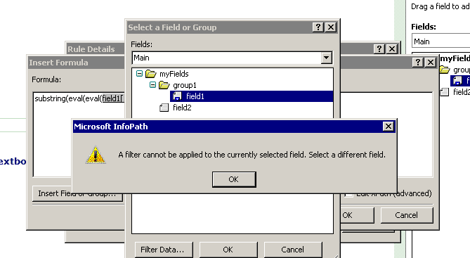

    Hi Jimmy, I had a similar requirement and was trying to use your formula, but when I am trying to filter the field1 , I am getting an error message as shown in the attached image. Please let me know if I am missing anything. Thanks,
