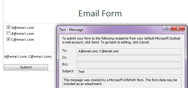

    You can use the eval function to concatenate the selected email addresses.
    So if your data source is structured like
    myFields
         UserList (parent group)
             emailAddress (child repeating field)
    Your formula would be: eval(eval(emailAddress, 'concat(., substring(";", 1, string-length(.)), " ")'), "..")
    You use this formula in your Email Submit data connection's "To" field. You should be getting the result as shown in the image:
    I attached a sample form to get you started.
    Hope that helps!
