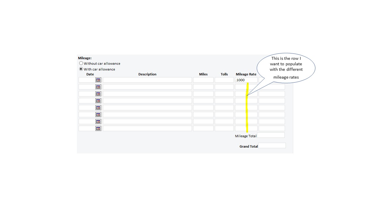

    Thanks, but your directions are a little vague. Can you elaborate? Thanks, John ~Update So this is what I want to accomplish and sorry if I butcher the explanation: 1. I have a Expense report that I have a section of mileage for users to fill out. 2. We have 2 different mileage rates for those with or without a car allowance. 3. I want to use radio buttons for users to click that would show either of the 2 rates for that column. (ex: click "Without Allowance" button and it populates 10 fields in that column w/ that rate) 4. I would like for the ladies in the accounting group to be able update the rates somewhere (easily) to reflect the rate change on this form. Hopefully this doesn't confuse too much. Thanks, John

    Hi Hillary, thanks for the quick reply. It would not vary by row and yes everything would be on one report with or without allowance. I have attached the form that I'm working with (hope that's OK) and also a screenshot of section I'm trying to make work. Thanks again, you're a great help! John

    Ok - so this data isn't repeating, which means you'll need to add a rule to set each field, unfortunately.... If the Mileage Rate would be the same for every row - perhaps it would be better not to have a field for each entry? Just have one field with the value? You could display it in each row - just use a calculated value to show it to the user. Here's an update of your form showing what I mean. Save it locally, right click and select design to open in design mode. Next, as to the secondary data - add a list to your site with a single entry and two columns - one for mileage with allowance, and one for mileage without. Then add a data connection to your form that queries for data from that list. You can then just pick the right info when the radio button is selected in your form - if you need help, attach a new copy of your form with the data connection added. :)

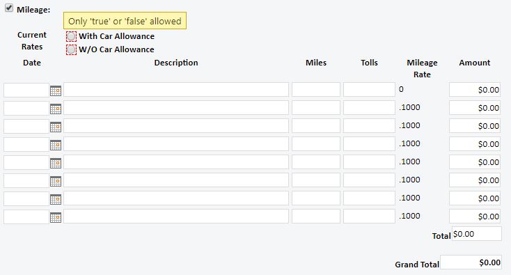

    Thank you soooooo much for helping with this Hillary. Unfortunately, it still isn't working. I removed the MileageRate field (because I just included this as an example) and updated the form to look like it's supposed to look and work. Now I'm getting the error when selecting With or Without car allowance buttons "only 'true' or 'false' allowed" I attached the template for your review Thanks again, John
  • 01-25-2019 10:14 AM In reply to
    Re: Pulling info from an external Data source to a text field
    Sorry here's the screen shot of the error

    So - I don't understand why the MileageRate1 field, which is a true / false field, is being used in the repeating table... shouldn't the mileage rate in the repeating table (the calculated value) be bound to a number field? The field called "MileageRate" which I was guessing would be the actual rate, looks like it is a choice field - what are the choices for that field?
