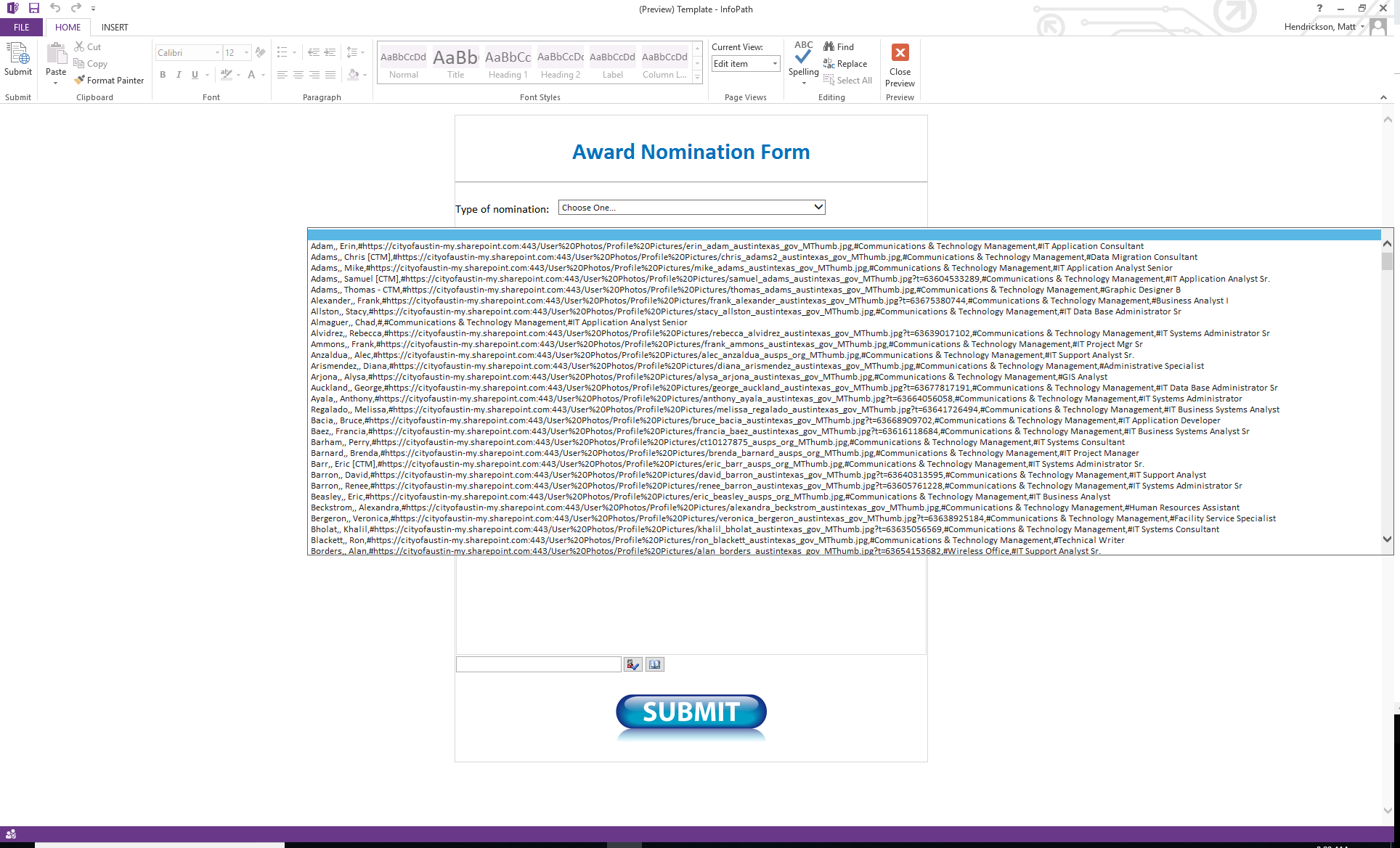

    I changed the employee field to point to a people picker field, and the attached screenshot is the result. Does it matter if the first is a people picker when they can verify the supervisor in the same row using ID?

    I must have been unclear. What I was asking was about the supervisor field in the secondary data source. If your employee field is just the display name, that's fine - but I thought you wanted to populate a people picker in your form for the Supervisor? To do that, we need the Supervisors account ID and display name.
