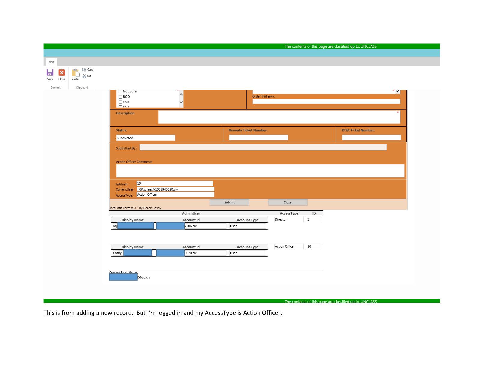

    WOW!!!   Not sure what you did, but it's now working.  Also I did have to do OR instead of AND in the formatting conditions.  Attached is a screenshot of me logging in as Action Officer, which did only show the action officer block.
    Thanks!

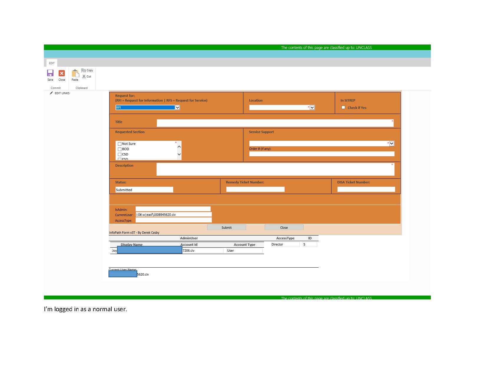

     I couldn't upload both pictures...this one shows me logged in as a normal user.
    Again Thanks!
