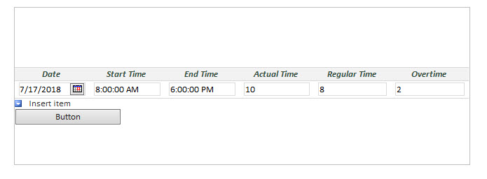

    I tried this application but was not successful. Your field1 for me would be a calc field called ActualTime that displays the difference in time in decimal format for total hours entered that day (punch in/out). That field should show the total time regardless, then it should be populating a RegTime field with up to 8 hours and anything over 8 hours into a field called OverTime all based on the ActualTime field.. The end results would show as attached where fields ActualTime, RegularTime, OverTime would all be auto populated based on my scenario. I think we are close though.

    I got it! I just had to play with where the rules were placed and where they were pointing to! Thank you!
  • 07-17-2018 08:28 AM In reply to
    Re: Rule or XPath to Return Result?
    Glad you got it working! One thing that I found hard to remember when I started with InfoPath was where rules go - you want your rules on the field that will be changing. Action rules fire when a field changes, so if you want to set fieldB when fieldA has a certain value, the rule goes on fieldA. :-)
