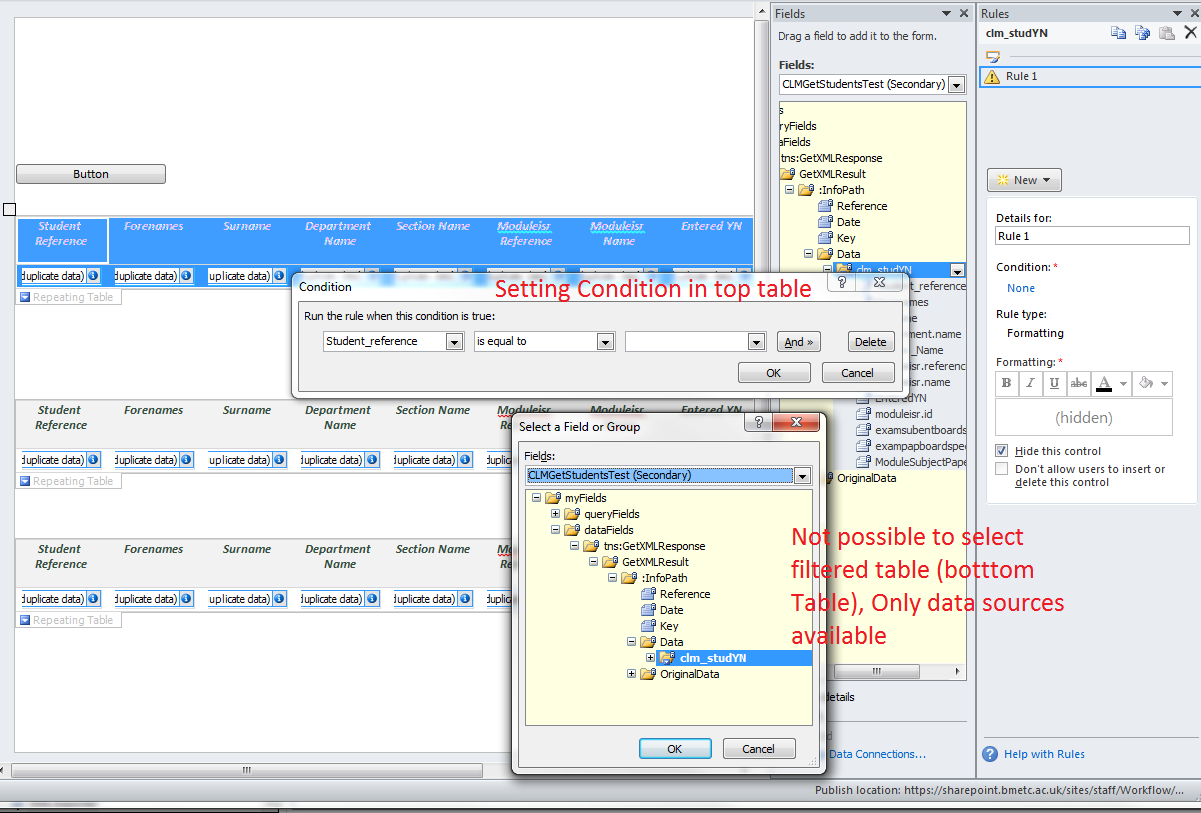

    I think I have realised where the problem is as it still does not work for me. I placed the secondary datasource on the canvas within a repeating table. Then created a rule to  hide some rows based on other fields on the form.
    So now when I try to Filter for the difference on the main datasource, If I was to select the secondary datasource then this is the original data and not filtered.
    So I think the main datasource needs to filter the data on the actual form, not the original data source, however this is derived (linked) directly from the secondary datasource. Perhaps these need to be different controls so I can pick them up when I attempt to filter the main datasource?

    The difference table should have only one conditional formatting (displaying difference of the two tables). Its meant display results (All results minus Already entered)  based on Stutent Reference
    Already Entered table has a conditional format to display students from a specific subject, At the moment I've hard wired this but later it will grab filter information from the form. I think because I have applied filtering here it interferes with creating the correct rule for the difference table above because difference rule uses the datasource and not the filtered table.

    I've modified your sample file to highlight the problem I'm facing and also added some info in the sample to explain issue.
    I think it may simply be an adjustment in the rule applied to the results table to take account of hidden rows in Table B, might require a nested rule?
