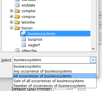

  • 05-25-2017 10:02 AM In reply to
    Re: Create Rule Based On Multiple-Selection List Choice
    I wouldn't bother with the additional field & would just use a condition if all occurrences of bysinessystems is not equal to QAD - Eagle RF on the dropdown.

  • 05-26-2017 07:43 AM In reply to
    I used InfoPath for *years* before I noticed that little dropdown when selecting repeating fields, by the way, so I like to point it out whenever I have a chance. :)
