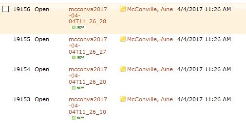

     Now to the issue: Particular users (not everyone) seem to have an odd issue where several submissions are happening in rapid succession. In the attached screenshot we see that we have a 2nd doc created 10 seconds later, a 3rd 7 seconds after that, and a 4th 1(!) second later.

     Thanks again. I talked to a user today that I saw had one of these multi-submits and asked if his browser refreshed or anything while he was filling out the form... the answer was no. The form that ended up getting properly completed ended up being the first file; the extra copies were created after. So it seems like somehow these Form Load rules are running and executing additional times in the background WHILE the original is still being filled out. Strange.

     I found out the root cause! I have a people picker field that adds those selected into the CC field of an email that goes out upon form completion. When users manually type into the people picker rather than use the actual buttons, when the picker 'fails' (types the name incorrectly) it posts back to the server and creates a new document in the background. Now I just need to figure out how to stop that! :)
