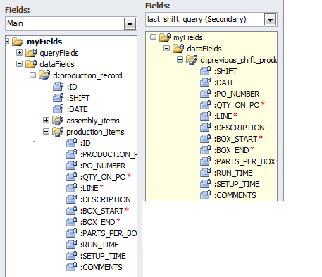

    Help! :) So here's my code, and an attached picture of my data sources. I was essentially trying to follow what was going on here: http://www.bizsupportonline.net/infopath2007/4-way-programmatically-add-row-repeating-table.htm Again, the goal is to copy the data from the secondary source to the main data source.

  • 11-01-2016 03:17 PM In reply to
    Re: Pre-populating repeating section from database.
    Hmmm. A couple of things I notice in your "AddItem" method - you are starting with q:production_items - don't you want "d" instead of "q"? Then, at the end, you are using append child, after selecting d:production_items, but looking at your data source, don't you want to be appending this new child to d:production_record?
  • 11-01-2016 04:54 PM In reply to
    • kee81
    • Joined on 10-25-2016
    • Posts 9
    Oops, I originally had it as d:production_items. I was trying stuff out and forgot to change it back. I changed the bottom to try to append to d:production_record, but that's not working either. The final append line is throwing up a null reference exception. I'm doing something wrong in that statement and I'm not sure what.
  • 11-02-2016 09:36 AM In reply to
     Sorry, I should have seen that. You need to use the full path to the production_record group here - right click the field in the fields taskpane and select copy XPath.
    MainDataSource.CreateNavigator().SelectSingleNode("FULLPATHTOPRODUCTION_RECORD", NamespaceManager).AppendChild(doc.DocumentElement.CreateNavigator());
