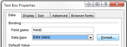

As to how a control displays a date value, you should be able to set that formatting in the control's properties as long as the data type is correct.
Hi Hilary,
That is not always the case, In a Text Field, the date will be formatted correctly as you mentioned above, but when you have a TextField that contains others field values including a Date Value, the Date will be formatted in a different way as: YYYY-MM-DD which is completely different then the date I selected at the first place.
TF
Yup - the format option is just for the date.

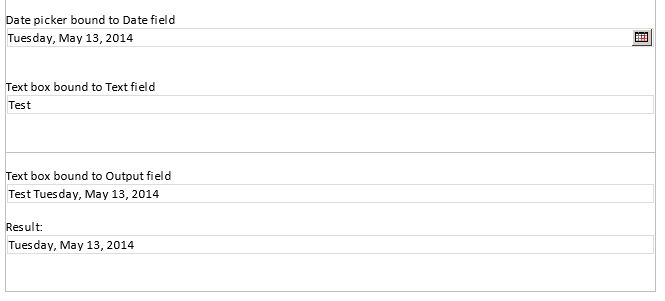

I found two problem, one is that there is something wrong with instruction, this was the formula we had concat("FormatDate /.=", ., " /format=D") but it should be changed to concat("FormatDate /date=", ., " /format=D"). Sorry about that.
Second, the form has custom code in it. If you do not need this custom code (looking at the form I do not think you do) please go to File, Form Options, Programming and click on Remove Code.
After you do those two, re-inject the form with qRules
Let me know if it works.

Remember the command we used, concat("FormatDate /date=", ., " /format=D")
The D in the specifies the format. That parameter came from these list of standard and non-standard formats:
You can replace the D with anything in that list that works for you. You can even delete the 3 fields you have for time. You can include the time in the date field in any format you want.
