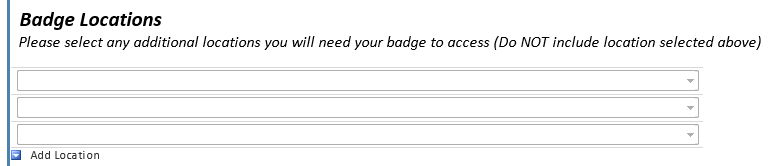

    I need to be able to clear the data from a repeating table and delete all but the first row on a submit button. I think I should be able to do this with Qrules, but haven't been able to figure it out. Any help would be greatly appreciated.

    Ok, so this worked to a point. First I had to put the /field at the end of the delete command because it was returning an error that it couldn't find the field to delete, now it's clearing the data from the rows but not deleting the rows themselves. I took the insert command out just to test this part. If I put the insert back in it would insert the new parent at the bottom of the existing rows.
