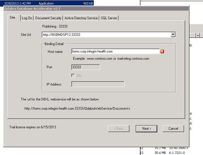

The way our SP farm is configured currently, the direct address to SharePoint 2010 is unsecured and installed as a separate site, i.e. http://mysite:33333/Publishing. We have a secured reference to the site, with a corresponding certificate, which is https://mysite.corp.org.com/Publishing. This secured connection references the aforementioned site application.
When installing DBXL, which includes the Active Directory Web Service QdabraWebService, my only installation choice was to the direct site application. I couldn't install to the secured site. So, in order for my web service calls in InfoPath to work, I referenced them via the unsecured URL. At first, none of my web service calls worked. They all threw the "5566" error with very little to find in the server logs. I noticed, however, that forms injected with qRules didn't have that issue. So, for baseline web service calls, whether I use qRules or not, I inject all forms. This seemed to alleviate the issue on initial form rendering and submission.
