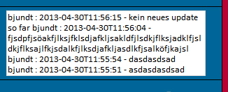

    I guess theres no way to format the Date in that comment-"function-rule"? cuz I dont like the "YYYY-MM-ddThh:mm:ss" -format just forget about it, I got a more important question :-) if I add more cmts. to the box, the text format isnt that good it just looks kinda messy. Ive attached a file where u can see the username + date + text.... any suggestions? I guess i just need some simple spaces/breaks/new lines....
  • 04-30-2013 07:30 AM In reply to
     You can use substring functions to sort of parse out the date the way you want to see it. I've seen people use secondary data sources w/ special characters in them before to add line breaks - is this a browser form? Or filler? I'm not sure if the line breaks tricks work in browser.

    its a browser form, probably thats the problem. I do some google research and try to solve, gonna reply if I got sth. new. thanks ben
