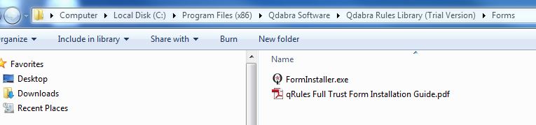

    I had qRules trial - good for one year, now expired.  I want to renew the license to keep using.  I downloaded the latest trial version today and don't see the "forms" described in Install Guide that are supposed to be in the Forms folder.  Is this because I need to update my license?
  • 03-26-2013 12:54 PM In reply to
     No - the forms should still be in the Forms folder - default path is here:
    C:\Program Files\Qdabra Software\Qdabra Rules Library (Trial Version)\Forms
    The trial is a full version, just expires.

    Ok.  That is where I'm looking but the forms are not there...see attached.

    I took the InfoPath Master Class in Nov-Dec 2011 and qRules were available to me for one year.  I do not know if I ever downloaded the trial then.  I do remember Hilary was showing me something in the forums using qRules once - but still not sure I downloade qRules to view that at the time.  The bottom line, I am not sure I ever had qRules Trial installed prior to today.  Attached is image showing my install from today....p.s. I see not other reference to another install.  Maybe I should run setup again???
    UPDATE: BINGO!! I ran setup again, this time option to "repair trail" install was available so I checked that and now the files appear.
