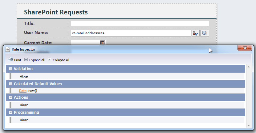

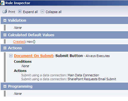

    I just noticed that issue I was having last week with rules disappearing, is happening again. The form I sent you has a button on it labeled "submit". Yesturday, I had a rule on that button that said, on submit send this data to the SP list and send an email. I clicked on the button and selected manage rulese. There are no rules. How is that happening? Did I create an invalid rule that InfoPath just removes because it is a bad format?
    I checked the rule inspector and it shows the rule on the submit button. I have to be doing something wrong here. Maybe I am not looking in the right palce to modify this rule.
  • 10-11-2012 07:19 AM In reply to
    Re: Submit email and post in SharePoint list
    The Rule Inspector on the form attached above doesn't have any rules configured.
    I'm sorry, I'm very confused about the scenario. I'll let others reply further.
