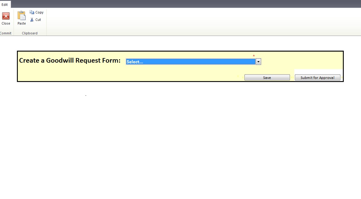

    I have been working with an InfoPath 2010 form that is the interface for a SharePoint2010 document library.  I have been modifying - saving - publishing to test without issue.  I then added a row to to table within a section and deleted a differnt row in that same section, which I have done before.  I tried to save and got the following error: "Users will not be able to open this form because of the security level it requires and because of the security level it requires and because no alternative access path has been specified.  To enable users to open this form, click Publish, and then add an an alternative access path in the Publishing Wizard. To save without adding an access path, click"   I have never added an alternative access path for any of my lists or libraries, or forms.  I have also noticed now when I view the form in IE now there are "shadows" behind my buttons...the cell is yellow but there is a large white space behind and above the button.

    I'd assume the view issue is something different - does it reproduce on other machines? That is, is the issue with your form or your machine? Can you attach a screenshot under the Options tab?

    As far as the issue with the View:  I had 2 content types associated with the document library. (A user added 50% more requirements to my project on delivery /heavy sigh). 1 form was the original. The other was new utilizing sections in lieu of multiple views. No data was changed.  I think the original forms was corrupt or something.  Once I removed the form everything works properly.  I am attaching a ss to show you what I was seeing.

    Oh that is just weird, isn't it? The background thing?

    And did you notice where the required field "*" was?  I must have gremlins.

    Hah - I knew something was off, but didn't put my finger on it - yeah, something was awry in that view. Some days I think IPFS is purely gremlin-powered.
