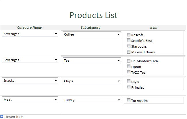

    I believe this is what you want:
    I've attached the sample form I created with these filters. You may change the data connections to your own so you could test.
    Hope that helps!
    Mel Clemente

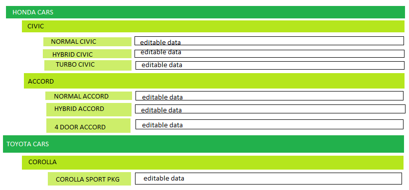

     Mel,
    That looks great, but I think there might be some confusion - I'm attaching a screenshot of what I'm looking for (note that this screenshot doesn't work, it's just a mockup).  The user is only entering data for the lowest level items.  The form will pull data from the first two lists.  In the screenshots, anything that is green is not editable.  I used the example of cars.
    Here are my sharepoint lists:
    • CarCategories (contains entries for HONDA CARS, TOYOTA CARS, etc). - fields: Name, ID
    • CarSubCategories (contains entries for CIVIC, ACCORD, COROLLA, etc.) - fields: Name, ID, Category
    • CarProducts (contains entries for NORMAL CIVIC, HYBRID CIVIC, TURBO CIVIC, NORMAL ACCORD, etc..) - fields: Name, ID, Category, Subcategory, Month, Price, etc..
    So the user would load the form, select the month and it would load all CarProducts - but sorted by category / subcategory for easier entry.  They won't be adding any new items.  I just can't get Sharepoint to filter the CarSubCategories level.  I even have all of the CarCategories / CarSubCategories data available at the CarProducts level - so if there's a way to just sort or "GROUP BY" in infopath on a repeating level, that would be great.
     Thanks for all the help so far!
    -Casey
