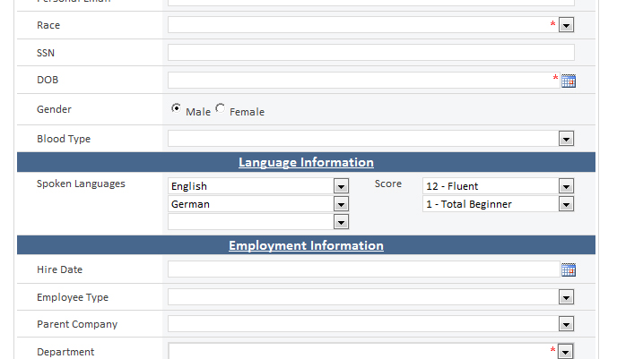

Thank you for the reply. My main data source itself is a sharepoint list. I can (and have previously in testing, and then again now following your steps) add secondary data connections and populate the lists accordingly. The problem is, that I need the repeating table behavior of allowing my end user to "add a new row" so that as the linguist info is being entered, they can select all applicable languages from a dropdown and affix a corresponding language score to it. I basically need the exact functionality that is in the template, but then write the data to a sharepoint list.
As an aside, I did look into using libraries which is what I've seen recommended for more complex forms. The downside (as far as I can tell) with using a SharePoint library is that each entry appears to be a document of its own. I'm really trying to keep this as close to a relational database as possible. I think I'm going to investigate straight up database options. This just seems to be a pretty trivial need.
Thank you for all of your replies. After much thought, I have given up on it and come up with an acceptable work around. I've created 8 static fields for languages and 8 static fields for scores. Presumably, it would be a very rare occasion that one person would know more than 8 languages. I then used some rules to hide the controls based on the input of the previous control. Adding this all to one cell gives the illusion of the dynamic controls that I was looking for.

warrtalon:InfoPath list forms cannot have repeating data like this, so you need to decide if you're going to be ok with having a separate list item per language per person or not. If not, then you're going to have to create a non-repeating table with 12 rows and a header that contains one column for language and another for score

I know you keep referring to this as being very easy outside the confines of SharePoint, but unless I'm completely missing something, then I'm not sure that is the case. The reason I say this is you referred to keeping it as close to a relational database as possible, but the design you've been going for is not how a relational database works. Database don't have repeating fields either. You've been trying to insert one record into SharePoint that has two fields with multiple rows of data within them. IN a pure database scenario, there would be one record for each language/score pair, right? Also, each language/score would be associated/related to a user object from another table. That's two tables - one with unique records for each user and another with unique records for each language/score pair that also includes a foreign key connection to the user table. In SharePOint, you're trying to add both of those into one table - a single user object with multiple language/score pair rows embedded within the same row. That's not relational, so I don't think it's valid to say that this can be done with databases. This is why I suggested two methods: one horizontal and one vertical.
I don't know how a database would be able to handle multiple rows embedded within one row of a table, which is how I've been understanding your request.
Lets say in Visual Basic or ASP...
I would have created 3 tables in my database, 1 for the Employee data, 1 for the Language data, and one for the Score data. Then I would build the relation in code through the use of joins or create a view for the joins. I would populate the language list with its respective table data and hard code the score drop down. I would then submit back into the Score data table with (user_id,language_id,score). Then pull the relation at run time or during reports.
I wouldn't try to embed multiple rows within one table row. No excuse for why I was trying to do it with this list.
For what it's worth, my real brain buster was that I was hung up on thinking I needed repeating tables for the functionality of what I would normally do with style sheets (hiding controls). And then of course, couldn't build a relationship. It was a given all along that I could do multiple fields, but I didn't see how I could hide them from the user (until I found that I could do this with rules).
