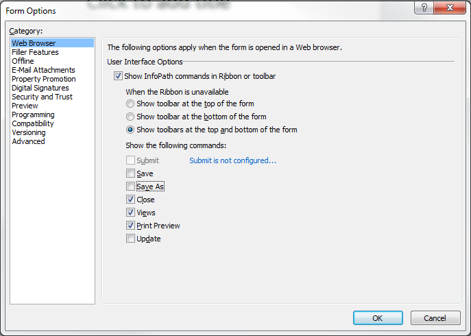

But if we disable Save and Save As, the toolbar buttons Submit & Close disappear. I am saving the form to document library on Submit.
You can bind a button in your view to the Submit operation and just have it Submit to the SharePoint document library.
Yes, if we uncheck Save and Save As options under Web Browser settings, Close and Submit will still be there. The issue I am facing is when user clicks on Close and if he has done some changes in the form, Save As dialog box will appear and user will be able to save the form with his preferred name. The functionality I was expecting from toolbar buttons is Submit button will submit (Save) the from to the document library in moss with autogenerated form name, the Close button will work as Cancel button (Close the form without promting for saving the form even if there is some change made by the user). As Patrick suggested, it won't be possible to change functionality of standard Close button without writing deep code. So I have used custom Close button which closes the form without Save As promt. I am still using other buttons from the standard toolbar only. I have customized close button not to look like custom button as Close (X).

Hilary Stoupa:You can attach a screenshot under the Options tab in a reply. If all else fails, use IE :-) You can also just attach your template and I'd be happy to take a look.
Feeling pretty foolish. I didn't think to try IE. Thanks for the heads up! Here is my screenshot.
