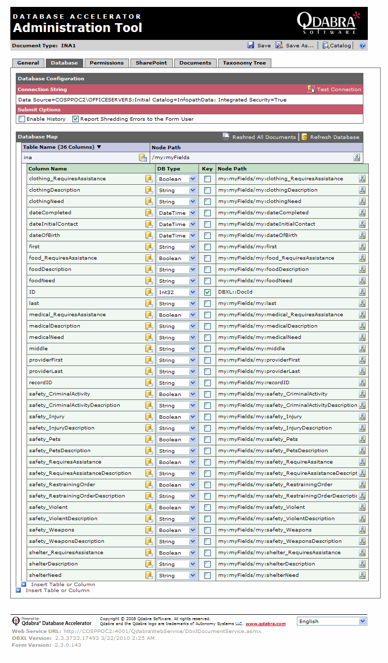

    Can you include a screenshot of the database mapping tab in DAT, and also check eventvwr for any errors?

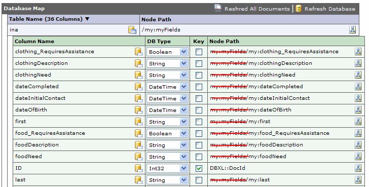

    Re: DBXL submit to SQL server is creating NULL records
    Attached is the screeshot.  I checked the event viewer.  There are no new errors.  All existing ones are old errors when I had the configuration incorrect.

    The node path is relative to the parent node path, so you will need to remove the my:myFields/ from the column node paths

    Hi binoj,
    The field paths must be relative to the table path. So if the table is mapped to my:fields, then all columns below must be mapped relative to that. You'll need to correct the database mapping to reflect this. I am attaching a screenshot to clarify this.
    Can you try this and let us know?
    Thanks!
