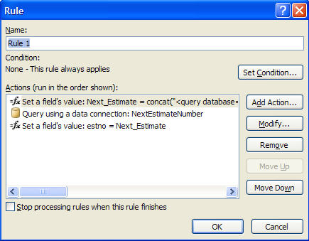

    Okay, now I'm really confused.  So I have attached a snapshot of my Rules actions in my estyear field :
     First Action: "It should not be setting a field in the main data source, but a field in the secondary data connection you created to QueryDB"
    So am I supposed to make the Next_Estimate (this is the field in my data connection in which I want to populate my estno field) equal to the concat query?
    Like this: Next_Estimate = concat("<query database='#Marketing_Resumes#' table='MaxEstimateNumber_Web' ><columns><column name='Branch_OfficeID'/><column name='Estimating_Group'/><column name='Estimate_Year'/><column name='Next_Estimate'/></columns><filter><and><eq><column name='Branch_OfficeID'/><value>", branchoffice, "</value></eq><eq><column name='Estimate_Year'/><value>", ., "</value></eq></and></filter></query>")    The period between the value tags after Estimate_Year are for estyear.
    Second Action: I selected Query a Data Connection and selected my NextEstimateNumber
    Third Action: I set my estno field = Next_Estimate
    An estimate number is returned but it is incorrect.  It looks like it is just pulling the Next_Estimate value from the first record in the my database table.
     Not sure what I'm missing here.

  • 04-02-2010 07:50 AM In reply to
    Re: Custom code best option for stored procedure?
    You'll need to change the first action to set the queryxml node in the secondary data connection. The execution steps then become:
    1. Set the value of queryxml of the the query data connection
    2. Execute the query data connection
    3. Set the desired field to the result obtained from the query data connection
