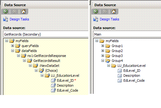

    Thanks. Replace worked for the example on Main.  But I want to go from a secondary source to Main.
    The attached photo shows my datasources.  I want to copy (or Replace?) from the top one to the bottom one.  I'm guessing I should use CopyTable. Although I used CopyTable before I'm not sure what would be the table and what would be the Row for the source and dest in this case.  I tried Replace but that probably doesn't work because of the repeating table.
    Here's my CopyTable command:
    CopyTable /tablesrc=/dfs:myFields/dfs:dataFields/ns1:GetRecordsResponse/ns1:GetRecordsResult/NewDataSet
    /rowsrc=LU_EducationLevel /tabledest=/my:myFields /rowdest=my:LU_EducationLevel /dsnamesrc=GetRecords
    and here's the error I get:
    An error has occurred executing the rule. The table row of the source and destination must contain the same number of elements and attributes.
    Dave

  • 01-29-2010 09:34 AM In reply to
    Ernesto,
    I appreciate you helping with this. I'd really like to get it working. What you suggested doesn't work either.
    I think the problem has something to do with the (Choice) node, which doesn't get mentioned at all in my QRules command.  I don't completely understand Choices and noticed that you can't Copy the XPath for that node.  Here's my command.  Shouldn't Choice be in there someplace?  Do I include the parenthesis?
    /rowsrc=LU_EducationLevel /dsnamesrc=GetRecords
    /tabledest=/my:myFields/my:Group4 /rowdest=my:LU_EducationLevel
    Here is the XPath from LU_EducationLevel under the GetRecords secondary datasource. Is the problem that this is not a table since it seems to skip right over the Choice node?
    /dfs:myFields/dfs:dataFields/ns1:GetRecordsResponse/ns1:GetRecordsResult/NewDataSet/LU_EducationLevel
    My new datasources are shown below.  I still get an "elements or attributes" mismatch.
    Dave
  • 01-29-2010 08:09 PM In reply to
    Re: Copy from one Group to another
     Hello and thank you for using qRules.
     (Choice) is not a node here, but an indicator in the taskpane to show that there should be 0 or 1 LU_Educational nodes underneath the NewDataSet node.  That could have something to do with the trouble you're having but let's try a few more things to try to make this work.
     One issue with your command is that the /rowdest parameter needs to indicate a repeating node (I think Ernesto slightly misunderstood this point).  Could you try changing your data source to make my:Group4 non-repeating and change my:LU_EducationLevel to be repeating, and then try the command again in its current format?
    Qdabra Software

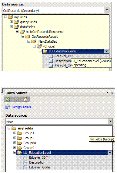

  • 01-30-2010 10:23 AM In reply to
    Jimmy,
    I fixed that problem but get the same result; An error has occurred executing the rule. The table row of the source and destination must contain the same number of elements and attributes.
     I noticed that in the secondary datasource, that LU_EducationLevel does not appear as repeating, even though there are multiple rows of them.  It's probably becasue Choice appears as repeating, but does QRules know that?
    Let me know if there's something else I can try, or if you need to see something else in my test project.  I'd be glad to post any screenshots that might help.
    Dave
