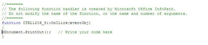

  • 04-21-2010 12:33 AM In reply to
    Re: Print a form from a button
    Hi Hilary,
    I've been trying to add the print button in IP 07 but I can't get it operational. IP keeps incisting that there is a fault in the code, and therefore it cannot excecute the action (or something like that).
    The code I've inserted is
    "function CTRL1206_5::OnClick(eventObj)
    XDocument.PrintOut(); // Write your code here
    (the " aren't actually in the code)
    Now this makes me feel like such an ass (the donkey, not the buttox), because I read everyone's messages sayin that it's SO easy, yet I can't get it operational,
    Could you please help me?
    Thanks a milion!
    Bart
  • 04-21-2010 12:50 AM In reply to
    try
    this.Print();
    Print functionality is avaibale only for client forms, it is not avaiable in browser enabled forms
    Qazi Anis
    Technical Architect
    Bitwise Inc
  • 04-21-2010 01:05 AM In reply to
    Hi Qazi,
    Thanks for the suggestion, but it still doesn't work :(
    I'm not sure if it is a client form of a browser enabled form, but I think it's a client form (infopath opens templates from a sharepoint library locally.

  • 04-21-2010 01:37 AM In reply to
    in the function
    use
    this.Print();
    instead of
    Qazi Anis
    Technical Architect
    Bitwise Inc
  • 04-21-2010 02:02 AM In reply to
     Hi Qazi,
    When I try the button in preview mode, I still get the message that IP could not execute because there is an arror in the form template...
    Thanks anyway!
