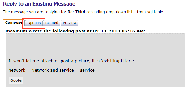

  • 09-14-2018 08:09 AM In reply to
    Re: Third cascading drop down list - from sql table
    When you click Reply there should be an options tab - see screenshot. If you change the first dropdown in each of your conditions to "the expression" the full XPath will display. Can you paste that into a reply?
