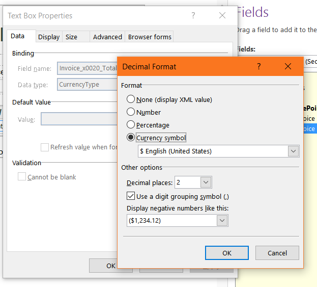

  • 02-09-2017 08:01 AM In reply to
    I'm pretty sure SharePoint is returning more decimal places than you may think. See the attached screenshot that shows the Invoice Total format settings - try changing that to "none" so you can see the actual value. Maybe do the same w/ Full Total, so you are seeing the actual XML value for both. Then you can figure out what to do from there. I think the number() function may help, actually, so try changing your comparison in your sample form to the expression: number(d:Invoice_x0020_Total) != number(xdXDocument:get-DOM()/my:myFields/my:FullTotal)

    Re: Format rule with currency
    Formatting settings simply determine how the data is displayed in SharePoint, not what the value actually is. So - set up your formatting as you had it then in the condition, change the first drop down to "the expression". After you do that, you can use the number function around each of the fields: number(d:Invoice_x0020_Total) != number(xdXDocument:get-DOM()/my:myFields/my:FullTotal)

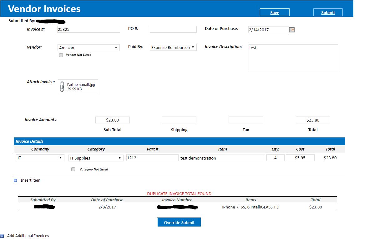

  • 02-14-2017 05:12 AM In reply to
    Thanks again Hilary. Everything is working great and the update to the form went into production this morning. All of your recommendations worked. I created a rule on the submit to check for duplicated invoice totals by using a query rule. Then setting a helper field to true if found. If an invoice total is exactly the same as the one they're currently filling out it is exposed in the secondary data connection table that you helped get working with this expression number(d:Invoice_x0020_Total) != number(xdXDocument:get-DOM()/my:myFields/my:Main/my:Invoices/my:FullTotal). If the invoice is still wants to be submitted, I expose an override submit button at the same time.
