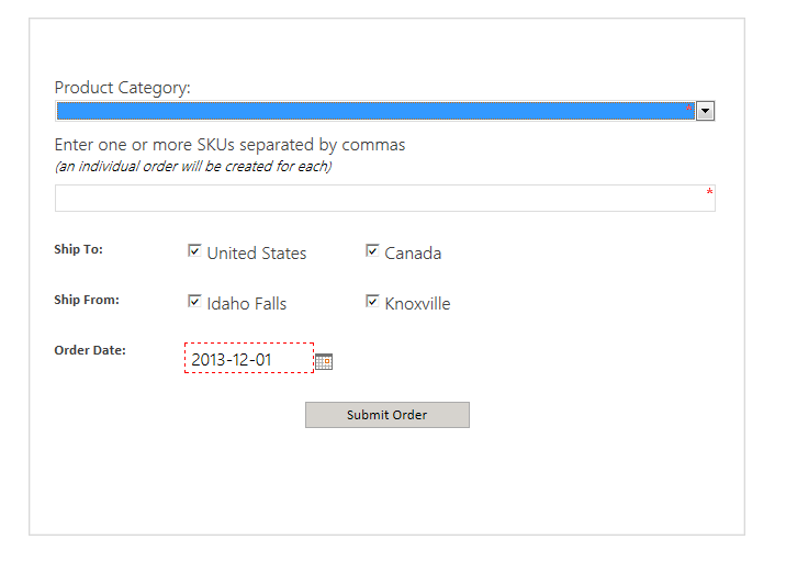

    Here is my problem. I'm using another date field to populate the Order Date field. The functionality is great and working fine, it's the formatting however that I can't figure out. I need the date to display as month/day/year format rather than year-month-day format. The form that you sent me is in the right format, but because I am using a SharePoint list and not a Form Library the date that is being pushed out is in the wrong format. Without the right format the user would have to retype in the correct format or use the calendar icon to pick a different date.
  • 11-07-2013 08:50 AM In reply to
    Re: Default Date to First Day of Next Month
    Ah, now I know what's up. We need to add " 00:00:00" to the date. That's a space and 0s for time for hours, minutes, etc. This is because SharePoint doesn't have a date data type, but has a date time data type. Can you try that? With a concat? And see if that helps?
