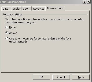

    Have you tried to change Infopath browser forms Postback settings of controls to Always from default "Only when necessary for correct rendering of the form (recommended)"?
    I mean that the parent page that contains the link to the InfoPath form does a full page refesh because the only way I can get it to refesh is by calling a location.reload in the javascript I use to open the form in a dialog. What I would like it a partial refesh like what occurs when you add a normal list item in SharePoint.
