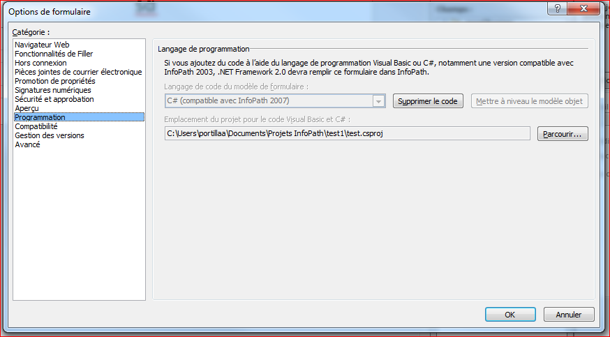

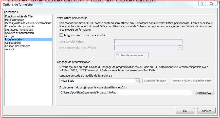

     So I just published the form with the same address (\\int.ec.gc.ca\shares\s\STL_COMMUN\TVE\REMPLIR_FORMULAIRE.xsn) on both dialogs in the wizard.
    I tried opening it and I got an error message saying that the code is not good (in the filler).
    I the design mode, it said that it couldn't find the code, that I had to find it in the browser.
    So on the picture attached, there's the location where the code project should be at the bottom. Should I put a location that is also on the shared files? If so, should I move the files? Create??

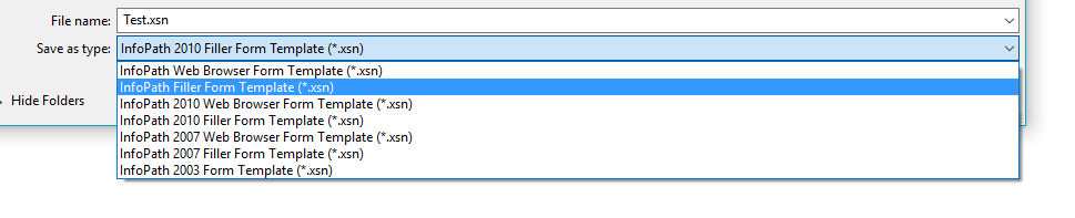

    Re: Shared network, managed code error
    You need to set the form to a Filler form under compatibility. Web Browser forms don't allow using code for Save. You should be able to use File > Save As > select the filler option from the dropdown. See attached screenshot.
